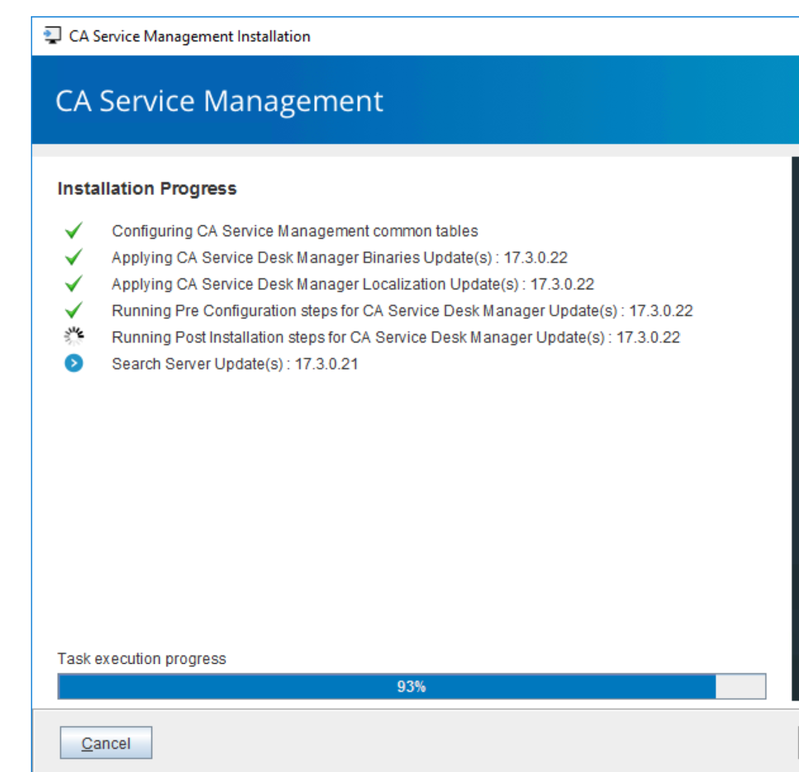

While applying RU22 on 17.3.0.16 one of the APP servers got stuck at 93%.
As per logs it is failing at step loading "upd_usp_servers_load.dat":
INFO  Task.java              215 Running: Update Miscellaneous data
INFO  UpdateMiscDataTask.java    96 ## loading D:\PROGRA~1\CA\SERVIC~1\data\upd_usp_servers_load.dat with (-u) options.
