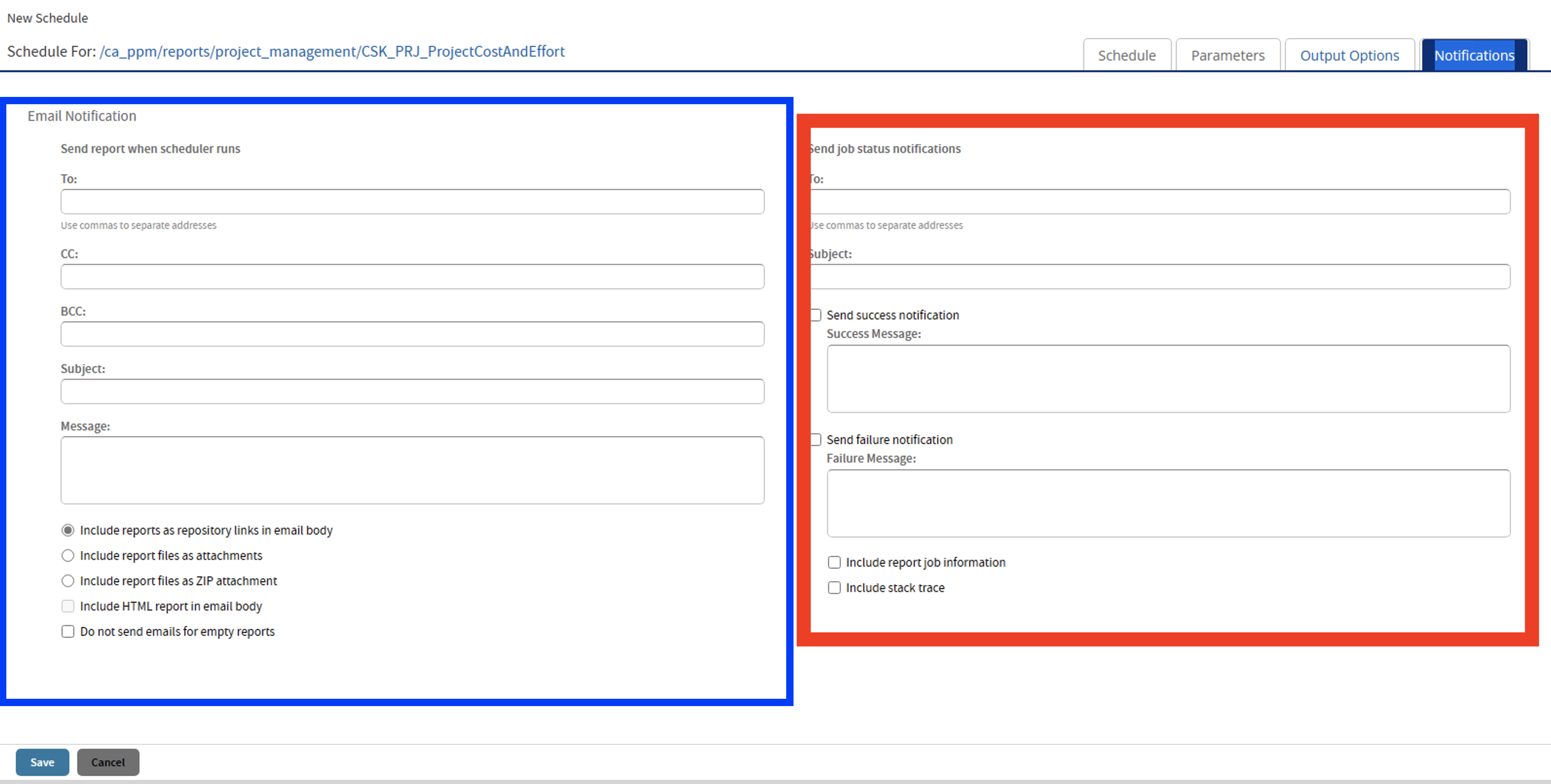

In regards to the Report scheduler configuration on the Jaspersoft side, if there is a failure of the report for X, Y, Z reasons the report failure notification goes to the "TO", "CC" and "BCC" of the email notification section boxed in blue (refer attached image). Business users are considering this as spams and do not expect to see error stack of the report, when they are only expecting the report.
Question:
Shouldn't the error stack go to only admin users on the right side of the configuration (Red side as per screenshot).
Providing a screenshot of the concerned report schedule (notification configuration).
Is this a defect ? or is there a configuration to control this behavior. This is not the ideal way it is described to work.
