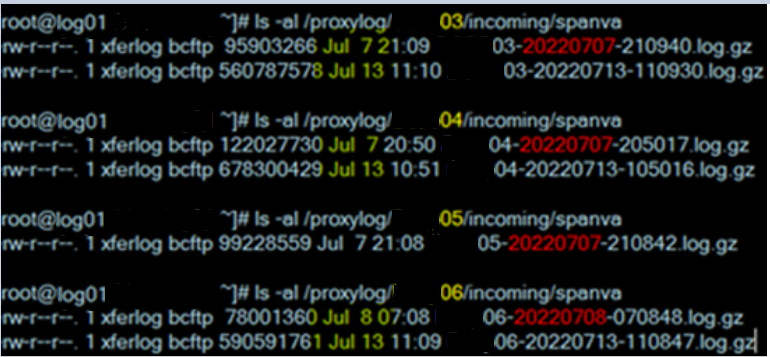

• SpanVA initially connected and copied the file(s) present soon after the Datasources were setup. However, subsequent logs experienced an anomaly where the oldest log file is left behind for each datasource.

7 Proxy SG's sending logs to a Linux FTP server where each has a datasource configured to pull logs to CloudSOC.

• There is a workaround where leaving a placeholder for each datasource has worked consistently. Any text file can serve as the 'placeholder' file. The behavior that occurs is that SpanVA sends all other files and leaves the placeholder files behind.
• If the placeholder file is removed, the issue returns where the oldest log file fails to transfer.
