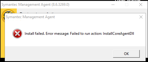

When the Symantec Management Agent is getting installed, you get the following error:
"Install failed. Error message: Failed to run action: InstallCoreAgentDll"

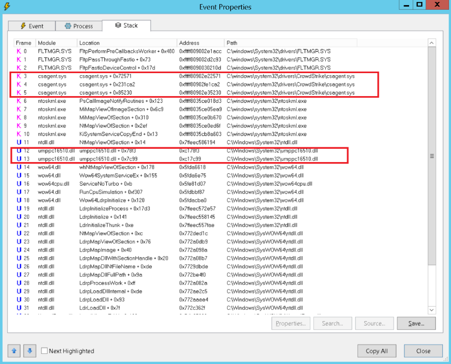

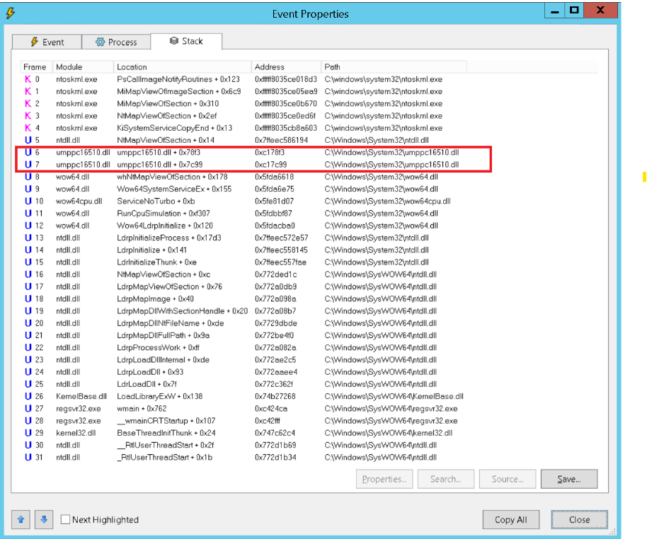

  • Here is CrowdStrike DLL injected in REGSVR32.EXE intercepting system LoadLibrary call, this is when regsvr32 loads our DLL.
Then, the same DLL is calling into some CrowdStrike driver right before the DLL loading fails with error 3:

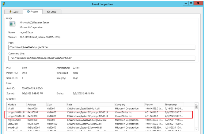

And now the company name that created those DLLs is seen:
