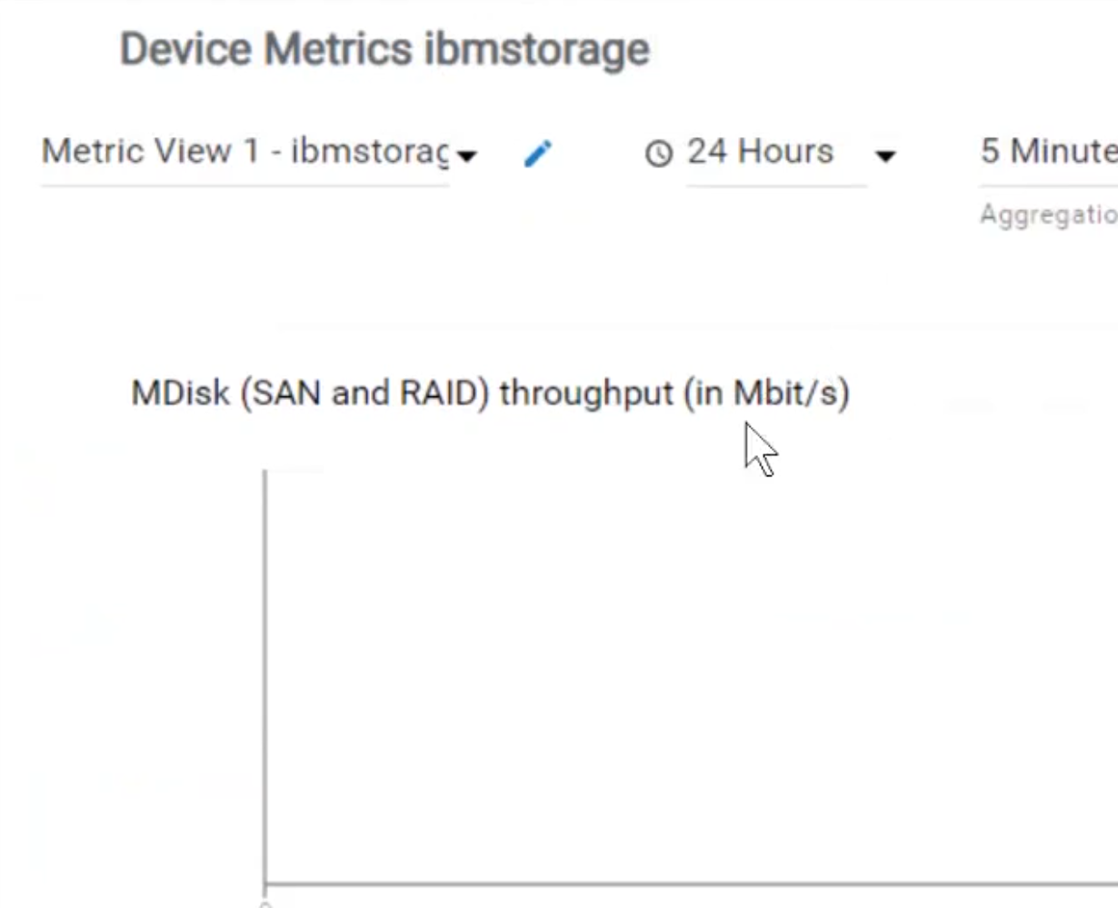

We are not getting Mdisk (SAN and RAID) throughput report in metric viewer
Related Metric
MDisk throughput    QOS_STORAGE_CLUSTER_MDISK_IO    MBps    MDisk (SAN and RAID) throughput    1.0
Release : 20.4.x
probe : ibm_svc 1.11
Storage type v7000
Cleared older qos data having null value causing the required metric to be not seen in metric viewer although being send by the ibm_svc probe and related data being collected in the database
