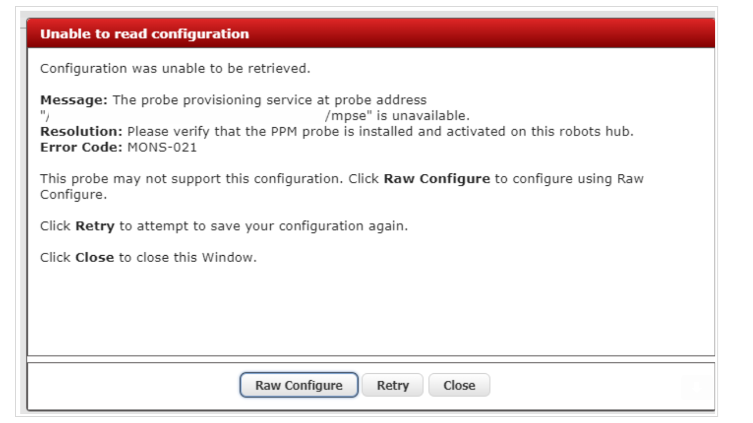

I have the snmpcollector probe that is installed on the customer hub, which is a secondary hub of our infrastructure, but when I try to open the probe using admin console I get this message:
PPM probe is up and running on the mentioned hub. There is a way to make it point to the primary hub?
