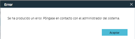

There is a problem at the moment of saving script changes on Service Catalog forms. If the size of the script is bigger than 1200 lines, an error message is returned.
Error message translation:  An error has occurred: Please contact your system administrator.
However, a shorter script can be saved without any problem.

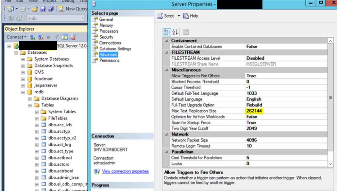

Right click on the Server name and select "Server Properties", then go to the "Advanced" tab.  Modify the max text replication size, setting it to a higher value.
