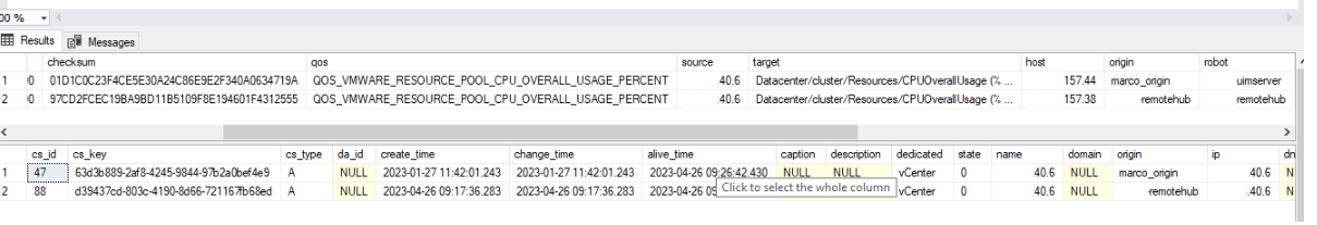

If you simply install the VMware probe on a new system with a new origin,  the VMs, and the Vcenter discovered will be registered as different new duplicated systems:
In the below example, it is shown how by only copying VMware settings into a new hub called "remotehub" with its default origin, different from the one we had in the first vmware "marco_origin". As soon as devices are discovered, as the origin is a strong decorrelator, a new instance of the same machine is created under that different Origin, with a new cs_id and consequently the QOS will be registered under that new source:

After the first polling cycles the VMware probe will start collecting the data and will not create new cs_ids as the newly discovered systems will be merged with the old ones and the same S_QOS_DATA rows will be used as the met_ids will remain intact.
The same S_QOS_DATA rows will be used for the same discovered targets. The same rows will have a new "host" IP which will correspond to the new VMware robot IP address.
