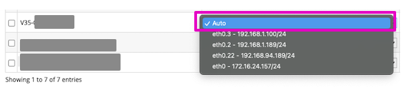

If a path is created using the 'auto' interface: then the monitoring point will check all available DNS servers across any interface, VLAN or otherwise:

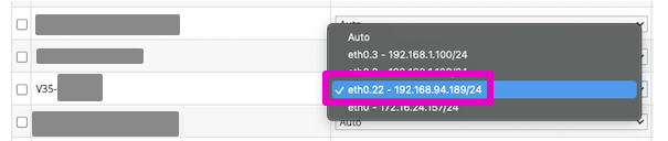

If a path is created from a specific interface or VLAN Interface: then only the DNS servers on the listed interface are used:
You can identify paths with specific interfaces by examining the path name:
