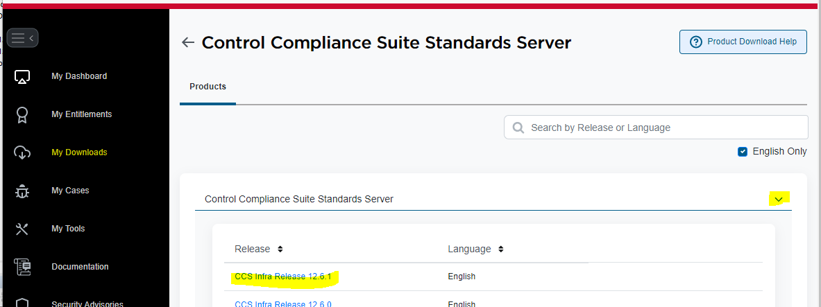

  1. Login to the support.broadcom.com
  2. Select the 'My Downloads' link on the left side, and then search for 'Control Compliance Suite'.  Select any product listed with Control Compliance Suite, i.e. Control Compliance Suite Standards Server
  3. Branch the different versions of CCS, and select CCS Infra Release 12.6.1

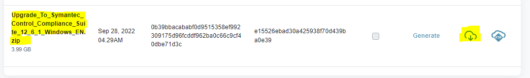

  4. Download Upgrade_To_Symantec_Control_Compliance_Suite_12_6_1_Windows_EN.zip and copy the zip file to the CCS Application Server.
    NOTE: If you get the error 'logout - errorBad Gateway' when starting the download, just try downloading it again.

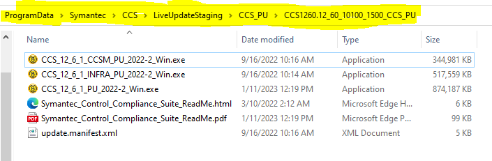

  1. On the CCS Application Server, unzip Upgrade_To_Symantec_Control_Compliance_Suite_12_6_1_Windows_EN.zip to a temporary folder.  Browse to the Upgrade_To_Symantec_Control_Compliance_Suite_12_6_1_Windows_EN\LiveUpdate folder for the following 6 files:
  2. Move any existing files and folders from the C:\ProgramData\Symantec\CCS\LiveUpdateStaging\CCS_PU folder to another location.
  3. Copy those 6 files to the C:\ProgramData\Symantec\CCS\LiveUpdateStaging\CCS_PU\CCS1260.12_60_10100_1500_CCS_PU folder.
    NOTE: Create the CCS1260.12_60_10100_1500_CCS_PU folder if it does not already exist)
  4. Once those files have been copied, as a user that has the CCS Administrator Role, open the CCS Console and then go to Admin -> LiveUpdate section, and under the Common Tasks dropdown select Refresh, then select Check Updates.  Once that completes, the option for CCS 12.6.1 should be listed in the LiveUpdate section.
