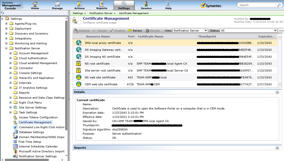

Certificate Management is not being updated. The Certificate Management page is found in the SMP Console under:
Settings > All Settings > Settings > Notification Server > Certificate Management
Certificate information should show up in Certificate Manager when the NS Report is enabled on the Internet Gateway (IG).  Disabling and then Enabling of the report causes an NSE be sent to the SMP and when processed, the Certificate Management page using the drop down for Internet Gateway should show a new GW with its certificate information.
