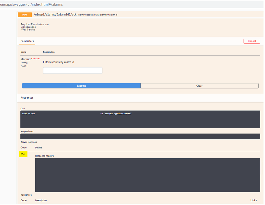

  • Using the uimapi, acknowledge the alarm using the specific NIM ID/alarm id.
  • Note that the response code is a little different for that result, a 204, but that is a successful return code in this case, e.g.,
  • Also note that you will get a 404 error if the alarm (alarm id) is already acknowledged. In the Response body of the uimapi call you will see "Alarm with given ID not found."

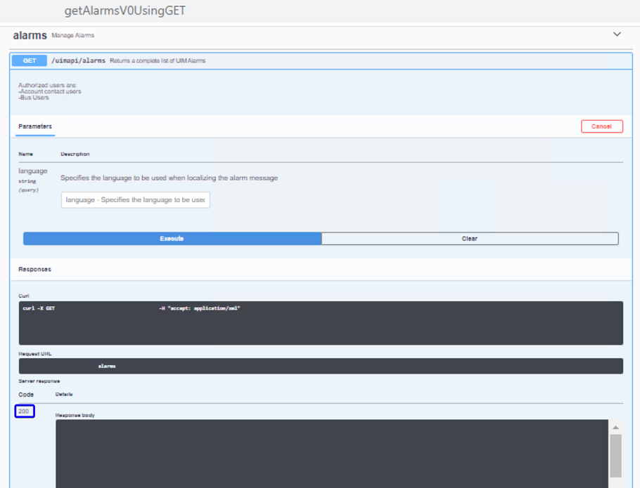

A simple test you can run in the uimapi is to get all alarms, Click the Get button, hen "Try it out" then "Execute the call.
example output:
When the ems is deactivated you will see uimapi alarm calls throw 500 and 404 errors.
