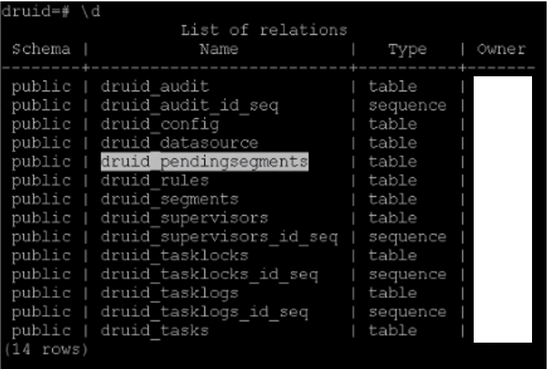

5. Connect to druid Database
\c druid
to list the tables inside druid db :
\d
6. Then run the Truncate Commands on the following tables :
druid-# truncate druid_tasklocks;
druid-# truncate druid_tasklogs;
druid-# truncate druid_tasks;
druid-# truncate druid_audit;
druid-# truncate druid_config;
druid-# truncate druid_dataSource;
druid-# truncate druid_pendingSegments;
druid-# truncate druid_rules;
druid-# truncate druid_segments;
druid-# truncate druid_supervisors; (edited)

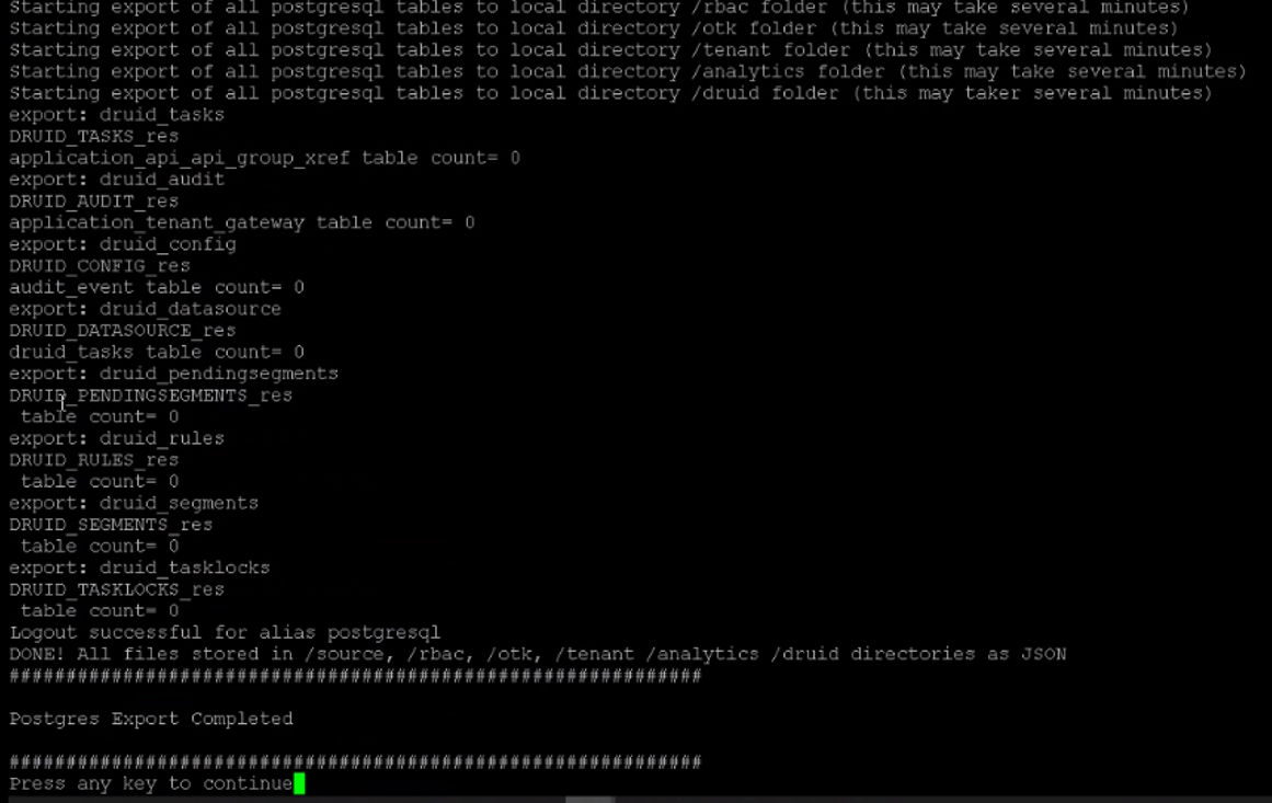

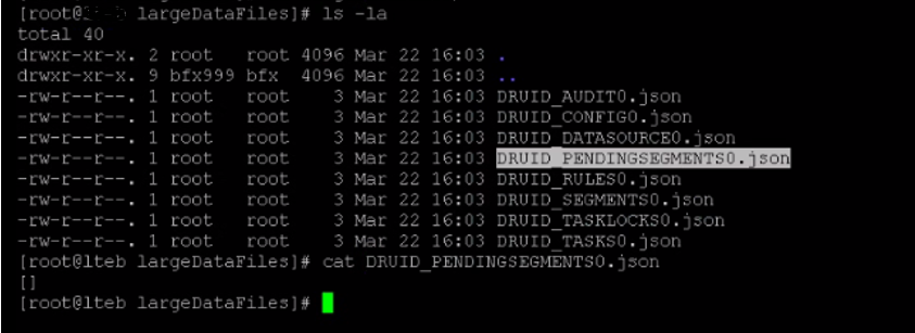

8. When running the migration again will see there is count=0 for Druid stuff
because the files were reduced also to the minimum size on largeDataFiles folder too, it will allow the migration process to finish without issue.
