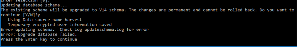

When upgrading Harvest to the latest version, the software installation succeeds but the database upgrade fails.  Hdbsetup returns this error message:
"Error updating schema.  Check log updateschema.log for error"

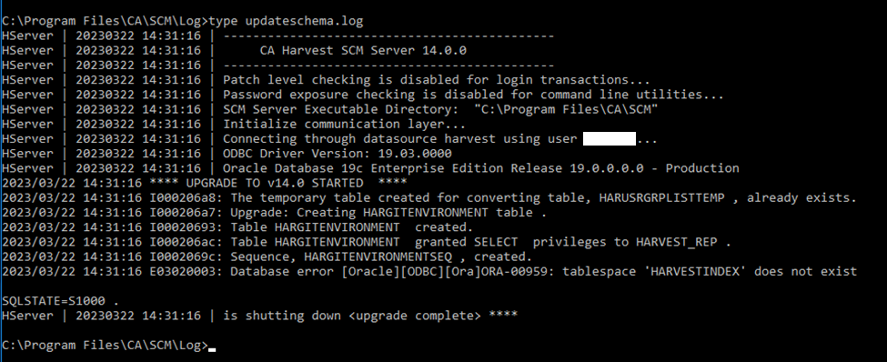

And the updateschema.log file returns this error:
2023/03/22 14:31:16 E03020003: Database error [Oracle][ODBC][Ora]ORA-00959: tablespace 'HARVESTINDEX' does not exist
SQLSTATE=S1000 .

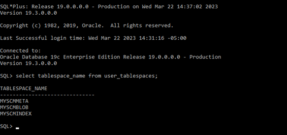

Logging into SQL Plus, we can get a list of the names of the tablespaces available to the harvest user:
This explains why hdbsetup could not find the HARVESTINDEX tablespace.  The DBA has renamed the Harvest tablespaces according to the naming standards he or the company has chosen.

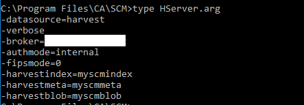

We must configure Harvest so that it can find the tablespaces it needs using the new tablespace names.  We do this by adding the following lines to the hserver.arg file:
-harvestindex=myscmindex
-harvestmeta=myscmmeta
-harvestblob=myscmblob

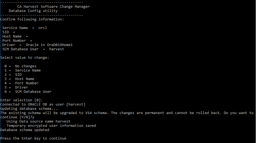

After completing this change, restart Hdbsetup and try the “UR” option again.
This time, the Upgrade Repository step succeeded.

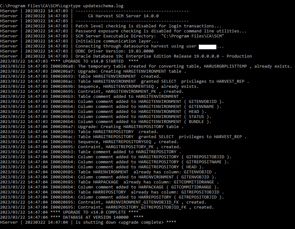

And checking the updateschema.log we see a much better result:
