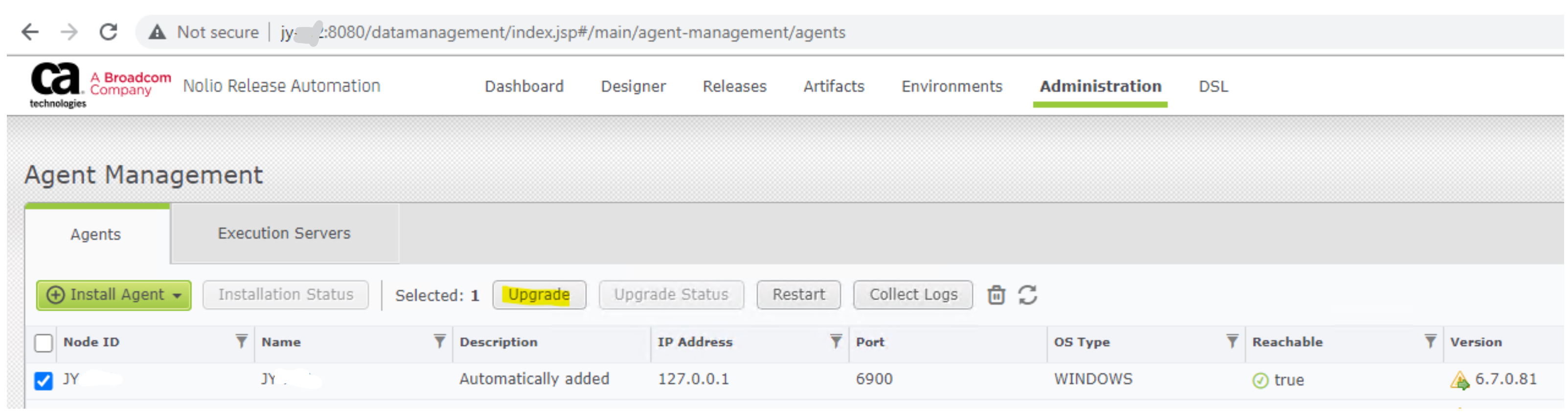

When pressing Upgrade button in Agents, nothing happens.
In nolio_dm_all.log there is following error :
2023-03-17T16:41:52.931Z [http-nio-8080-exec-5] INFO  (com.nolio.platform.server.dataservices.services.execmng.ExecutionServersServiceImpl:514) - Retrieving superNodes list for target server - es_JY-RA2
2023-03-17T16:41:52.932Z [http-nio-8080-exec-5] ERROR (com.nolio.releasecenter.controllers.v6.ExecutionServersRestController:125) - Controller method error occurred.
java.lang.IllegalArgumentException: loops not allowed

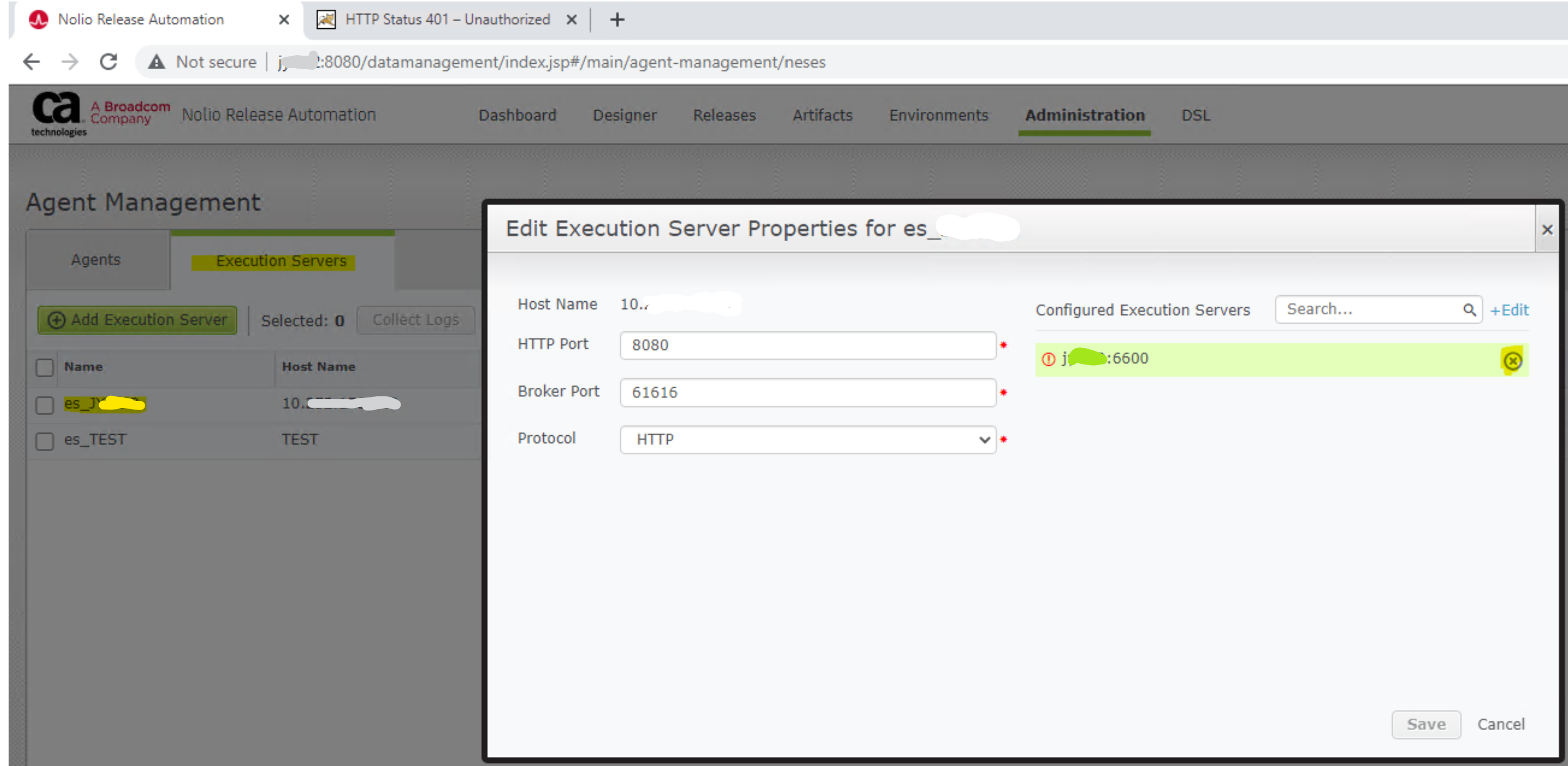

a ES node is linked to itself as supernode.
Following Query shows some rows with same value for server_id and super_node_id
select * from connected_super_nodes
1- Update the properties of "Execution Servers" and remove the links to itself.
Example :
In below screenshot JY-RA2 is linked to JY-RA2 (itself). We should remove the link by clicking on the red cross
https://api-broadcom-ca.wolkenservicedesk.com/attachment/get_attachment_content?uniqueFileId=9p88Dx4cEbNc7irQu7u7CQ==
2- If some NES is not reachable, it is not possible to remove the link using GUI.
But it could be deleted using a SQL Query
Execute following SQL Query :
DELETE FROM connected_super_nodes WHERE server_id=super_node_id
to remove the links NES to itself
3- Restart Nolio service on NAC
