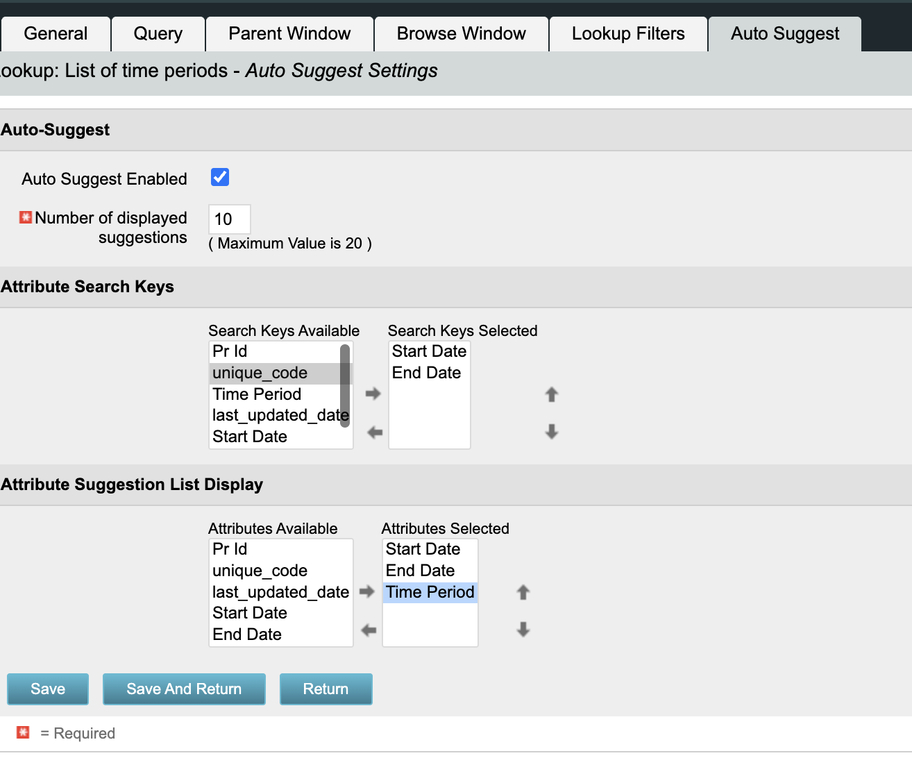

Workaround:
Introduce Time Period in the looup drop down. i.e. From Clarity Studio > Lookups > Open the concerned List of Time Periods lookup (Lookup ID: SCH_BROWSE_TIMEPERIOD) > Auto-suggest tab > Add Time Periods
Adding the additional field will lead to less confusion and users can type and filter for Time Period field values

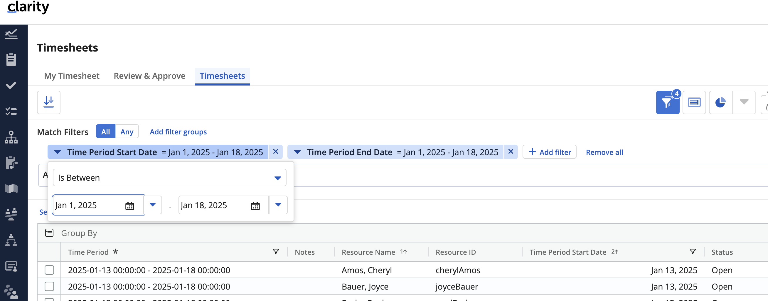

Alternate workaround would be to use Time Period Start Date and Time Period End Date fields as filters. e.g.
