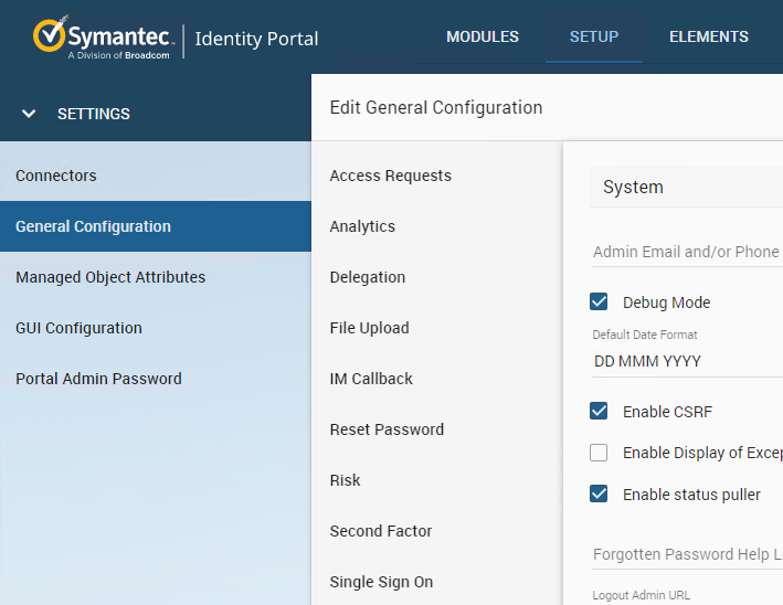

2 System > Debug:
Increases overall logging written into the Portal logs to DEBUG level.

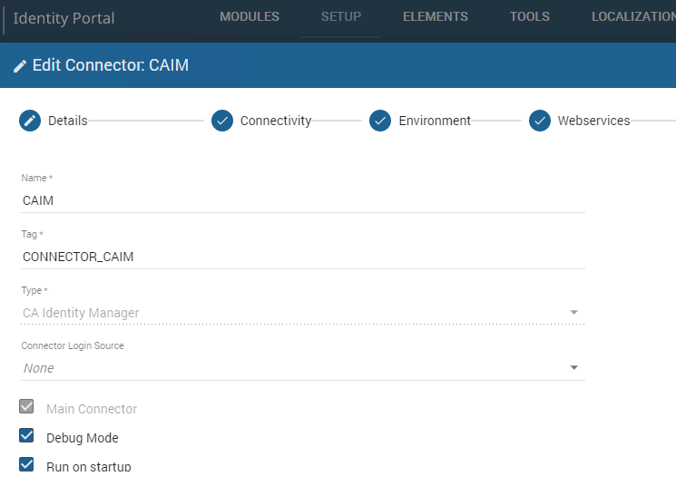

Connector Logging:
Writes DEBUG level logging specifically for the selected Connector.
