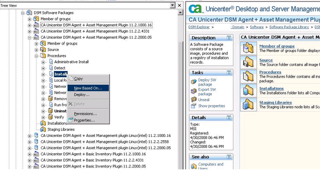

  1. Drill down to the 'Procedures' section of the package. Right-click on the procedure 'Install' and select 'New Based On'.
    (Fig. 1)

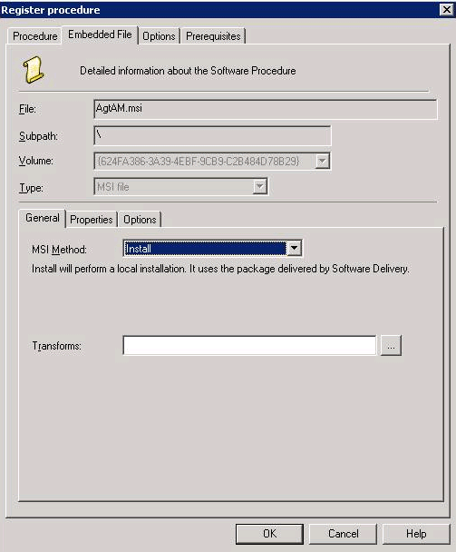

    In the pop up window, go to the 'Embedded File' tab.
  2.
  3. (Fig. 2)

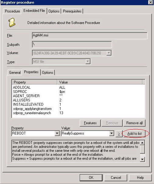

  4. Go to the 'Properties' sub-tab.
  5. Select 'REBOOT' and 'ReallySuppress' in the 'Property' and 'Value' fields respectively, using the drop down list as shown in the screenshot below:
    (Fig. 3)
  6. Click on 'Add to List'.
    (Fig. 4)

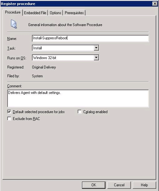

  7. Go back to the 'Procedure' tab and rename the item in the 'Name' field from 'Install' to 'Install-SuppressReboot' (or a useful name of your choice)
    (Fig. 5)

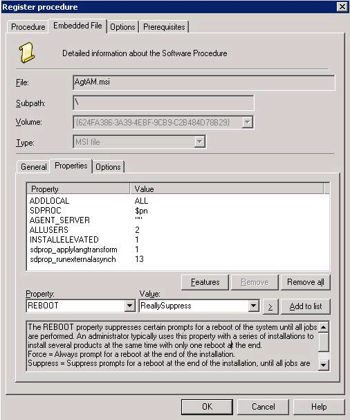

  8. Click 'OK'
    NOTE: You do NOT need to unseal the package to create the new procedure outlined above.
  9. Similarly, create procedures for all the agent plugin packages and push the added procedure to install/upgrade the plugin.
***NOTE: If any agent install fails with the error code '3010', it means that the install was successful, but the machine needs to be rebooted to complete the install. Keep a list of these machines so you know what boxes to reboot in the future.
