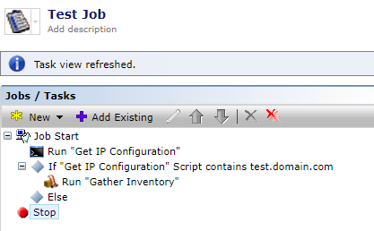

  2. One more idea might be to create a Client job, that could run Inventory task based on conditions, i.e. execute "get client IP configuration" and then run "Gather Inventory" task only if output of "get client IP configuration" contains Office network evidences as shown here:
