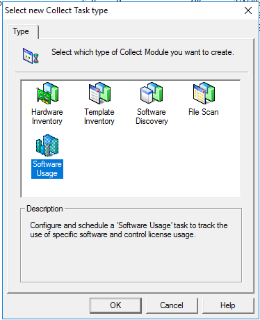

  3. Right-click on 'Collect Tasks' and select 'New'
  4. Select 'Software Usage'.
  5. Click 'OK'

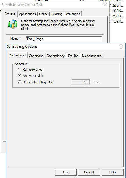

  6. Provide a name for the Task and set the desired scheduling.

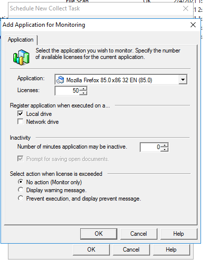

  7. Go to the 'Application' tab.
  8. Click 'Add'
  9. Select the desired app using the drop-down list.
  10. Uncheck 'Network Drive' unless this is applicable.
  11. Select 'No Action' radio button.
  12. Set the licenses to appropriate number or '32000' which is the maximum.
