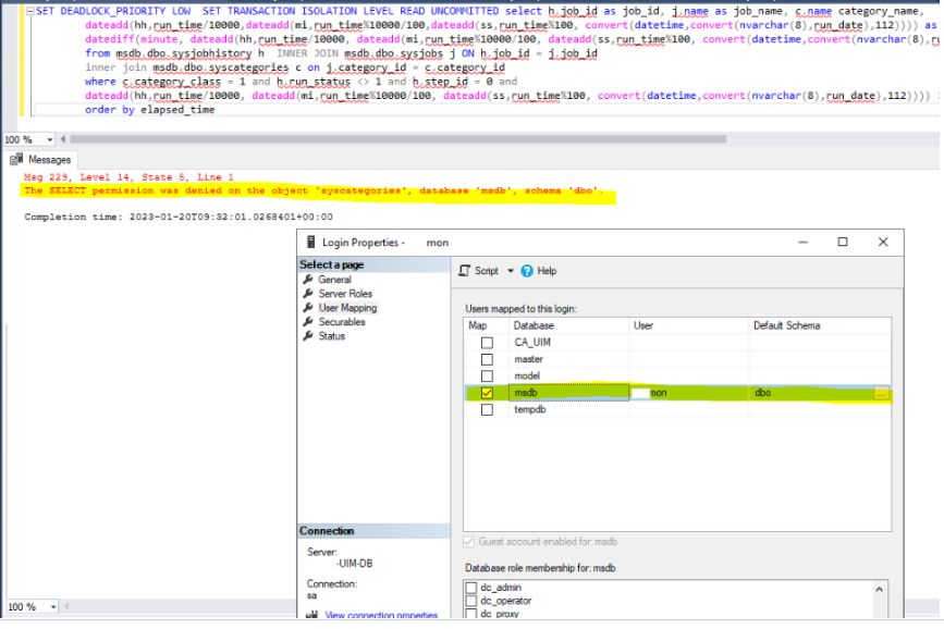

Please use the query in SQL Management Studio with the same user that is used in the probe and you should probably see the same permission error.
Please ask your DBA to gran access to the  system tables required in the DB.

Example of a user without enough permissions, error created:
Please engage your DBA and add db_owner for the msdb system table which is failing.

For this specific query that we are discussing, I was able to run it  granting the following permissoins:
    GRANT SELECT ON dbo.syscategories TO "user"
        GRANT SELECT ON dbo.sysjobs TO "user"
            GRANT SELECT ON dbo.sysjobhistory TO "user"
So without db_owner but with the above grants the query was successful. But you might want to GRANT all other tables to avoid errors with other tables.

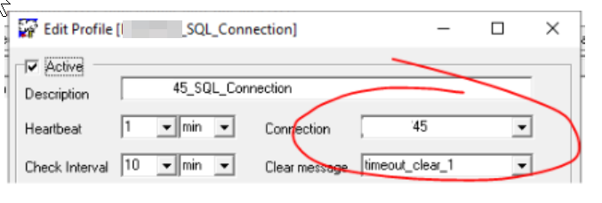

2. The connection name in the profile is wrong
Another scenario that can cause this issue is a bad connection in the profile.
Check if the connection visible in the profile or in the configuration file matches the connections available in the "Connections" tab.
If there is a mismatch, this issue will occur
Example:
If we look into the connections tab we can see that the connection in the profile does NOT match the connection name from the connections tab::
Use Raw configure to update the profile.
Save restart the probe and check if you are still seeing the same errors.
