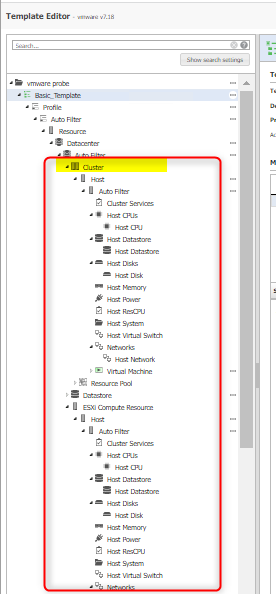

What sections of the template should I configure?
vCenter: If you set up the probe to connect to the vCenter, configure the section of the template that is labeled "Virtual Center VM." When you configure the Virtual Center VM section of the template, the template is applied to all the virtual machines in your vCenter.
If you want to monitor physical hosts in your vCenter, then also configure the section of the template that is labeled "Virtual Center Hosts."
ESXi: If you set up the probe to connect to the ESXi server, configure the section of the template that is labeled "ESXi Compute Resource."
Note
: If we look at a template, the sections for "Virtual Center VM" are actually labeled differently from what the docs indicate.
"Virtual Center VM" label would actually be the "Cluster" node:
                 Virtual Center VM (Cluster)
If you connect to a vCenter and only enable metrics under the "ESXi Compute Resource" section, it is possible that no VM's on the ESXi server will inherit the metrics.
The predefined templates offered by the probe have, for this reason, both "Virtual Center VM (Cluster)" and "ESXi Compute Resource" QOS enabled.
But it doesn't mean that the QOS will be duplicated. It will gather data either from the vCenter or from the VM's under the ESXi Server.
