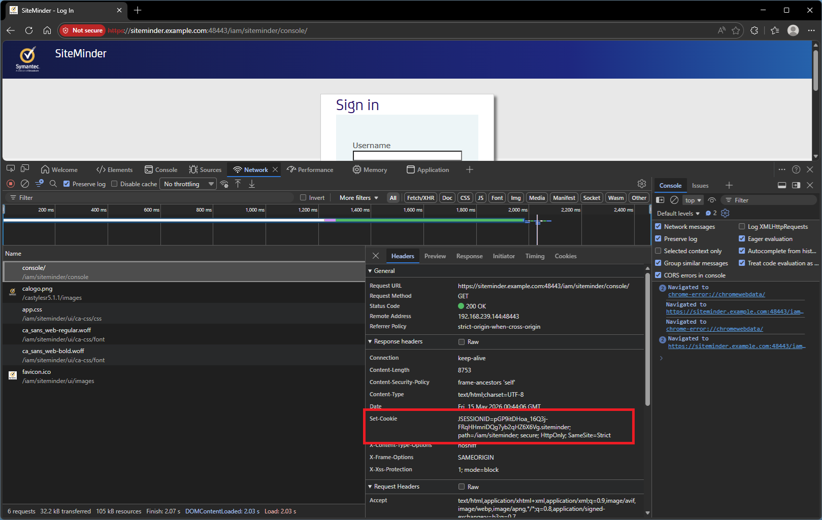

15) Using a web browser trace tool, logon to the Siteminder AdminUI and review the JSESSIONID cookie in the responses to verify the solution is working.

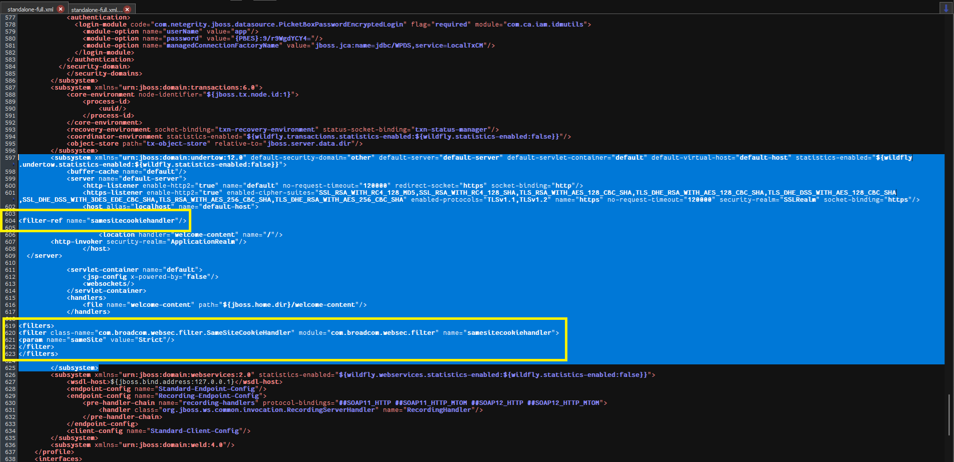

Following is after applying the configuration change in the actual standalone-full.xml
<subsystem xmlns="urn:jboss:domain:undertow:12.0" default-security-domain="other" default-server="default-server" default-servlet-container="default" default-virtual-host="default-host" statistics-enabled="${wildfly.undertow.statistics-enabled:${wildfly.statistics-enabled:false}}">
    <buffer-cache name="default"/>
    <server name="default-server">
        <http-listener enable-http2="true" name="default" no-request-timeout="120000" redirect-socket="https" socket-binding="http"/>
        <https-listener enable-http2="true" enabled-cipher-suites="SSL_RSA_WITH_RC4_128_MD5,SSL_RSA_WITH_RC4_128_SHA,TLS_RSA_WITH_AES_128_CBC_SHA,TLS_DHE_RSA_WITH_AES_128_CBC_SHA,TLS_DHE_DSS_WITH_AES_128_CBC_SHA,SSL_DHE_DSS_WITH_3DES_EDE_CBC_SHA,TLS_RSA_WITH_AES_256_CBC_SHA,TLS_DHE_RSA_WITH_AES_256_CBC_SHA" enabled-protocols="TLSv1.1,TLSv1.2" name="https" no-request-timeout="120000" security-realm="SSLRealm" socket-binding="https"/>
        <host alias="localhost" name="default-host">
            <filter-ref name="samesitecookiehandler"/>
            <location handler="welcome-content" name="/"/>
            <http-invoker security-realm="ApplicationRealm"/>
        </host>
    </server>
    <servlet-container name="default">
        <jsp-config x-powered-by="false"/>
        <websockets/>
    </servlet-container>
    <handlers>
        <file name="welcome-content" path="${jboss.home.dir}/welcome-content"/>
    </handlers>
    <filters>
        <filter class-name="com.broadcom.websec.filter.SameSiteCookieHandler" module="com.broadcom.websec.filter" name="samesitecookiehandler">
            <param name="SameSite" value="Strict"/>
        </filter>
    </filters>
</subsystem>

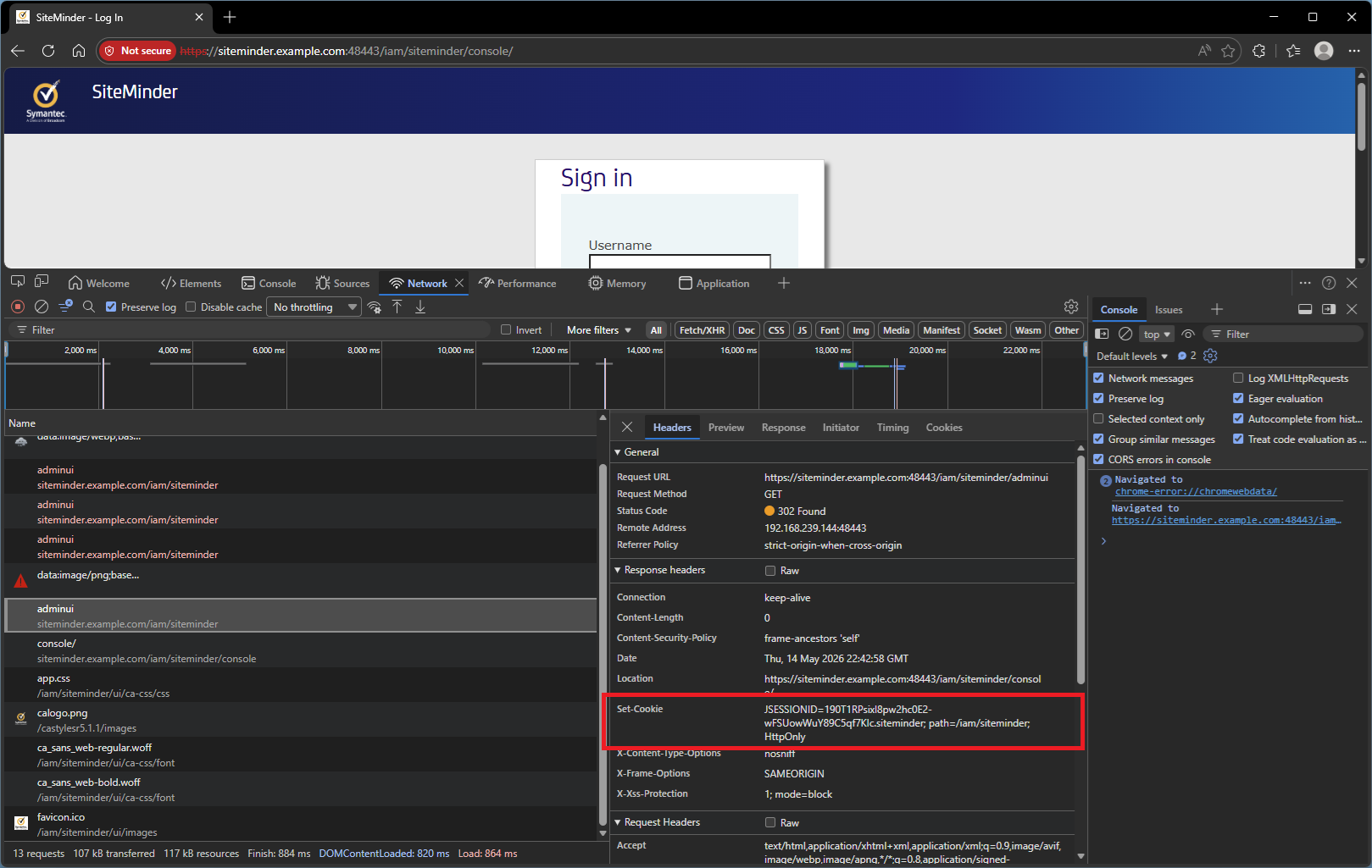

Following is sample set-cookie command before and after the patch+configuration.
