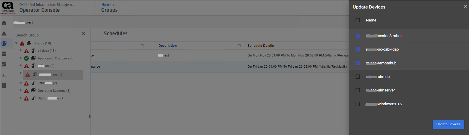

From a UI perspective (in OC), you can check which devices are currently in maintenance by going to:
Groups > Select the "Groups" node > Select the Maintenance Icon. You will see all maintenance schedules displayed (active and not active ones. Active maintenances are current) > 3 dots menu > Update devices and there you see the list of devices that are in maintenance.
On the example below, the selected devices on the right show the devices that are in maintenance for the selected maintenance.
