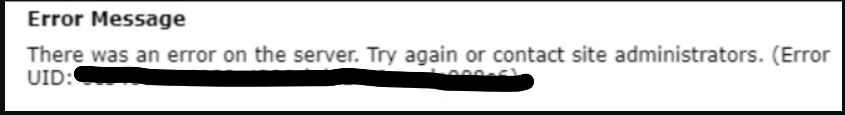

After fill in the Inputs, and run the report the next error message is displayed
and after click OK, another message appears
In <CABI_HOME>/apache-tomcat/webapps/jasperserver-pro/WEB-INF/logs/jasperserver.log only next is logged:
2023-01-16T08:37:24,328 ERROR SecureExceptionHandlerImpl,pool-14-thread-7:116 - There was an error on the server. Try again or contact site administrators. (Error UID: 6c5408c8-6033-4238-bd72-09eaade988e6)
2023-01-16T08:37:47,608 ERROR SecureExceptionHandlerImpl,pool-14-thread-7:116 - There was an error on the server. Try again or contact site administrators. (Error UID: 707b6de0-47dd-4a58-8d8a-700fd3022933)
