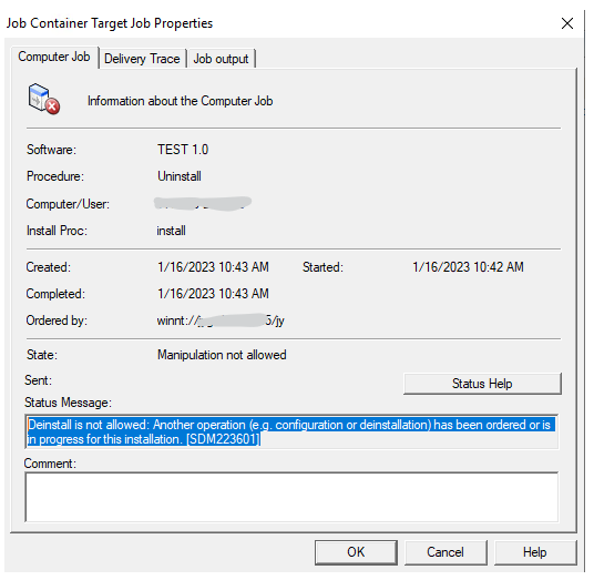

When trying to uninstall a SD Package following error appear :
State : Manipulation not allowed
Deinstall is not allowed: Another operation (e.g. configuration or deinstallation) has been ordered or is in progress for this installation. [SDM223601]
But there is no other uninstall SD job ordered or in progress.
