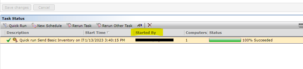

When you run a Job or Task, in the Task Status UI there is a "Started By" column showing a User that triggered the job or task as shown here:
Where is this information populated from?

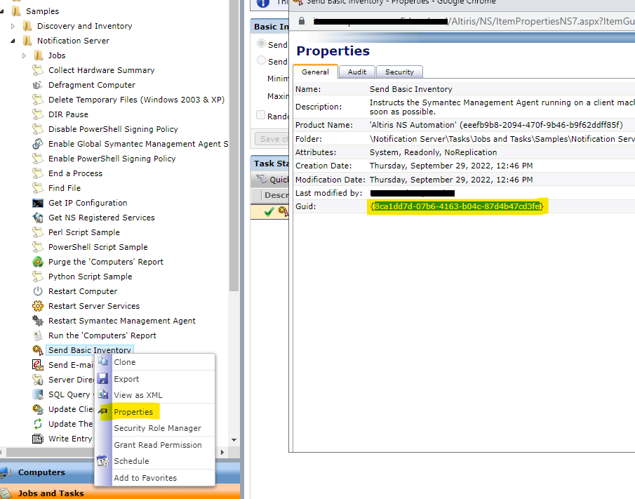

Note: You can usually find the GUID associated to an item by selecting the item>right-click>Properties and grab the GUID from the Properties UI that opens as seen here:
EXECUTE tmSelectSummariesForTaskWithChildren @TaskGuid='8ca1dd7d-07b6-4163-b04c-87d4b47cd3fe'
