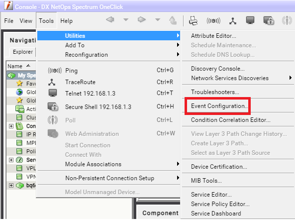

Launch Event Configuration:

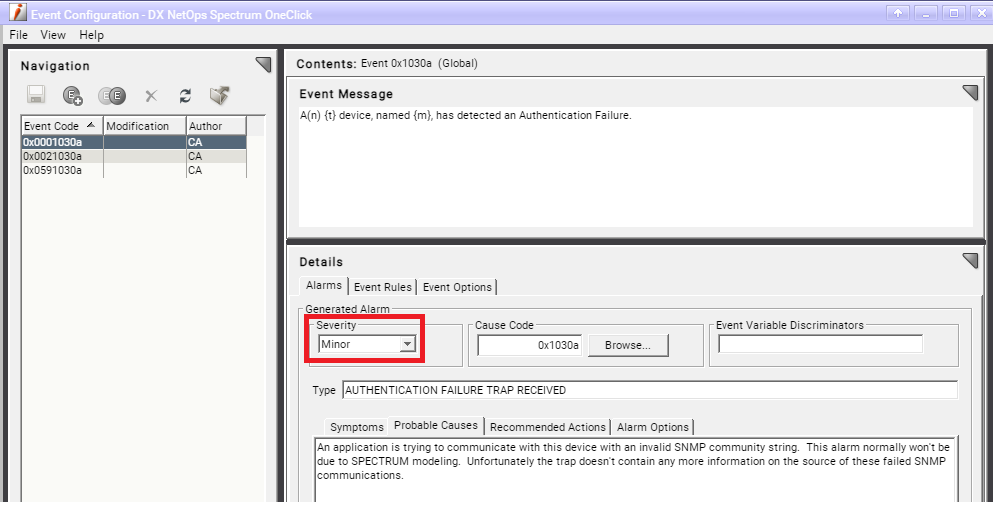

Search for event 0x1030a and change the Severity from Minor to None:

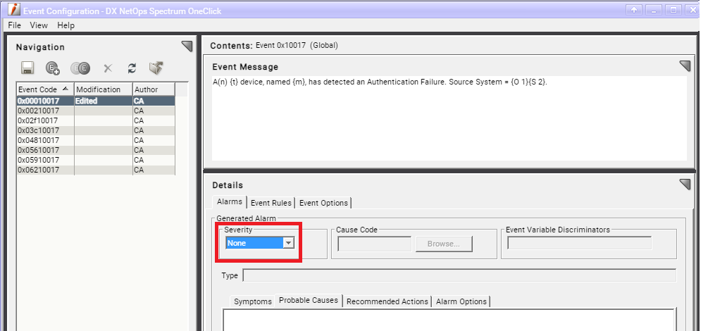

Do the same thing for event 0x10017:
Click the Save icon and press yes when it asks you to reload.
