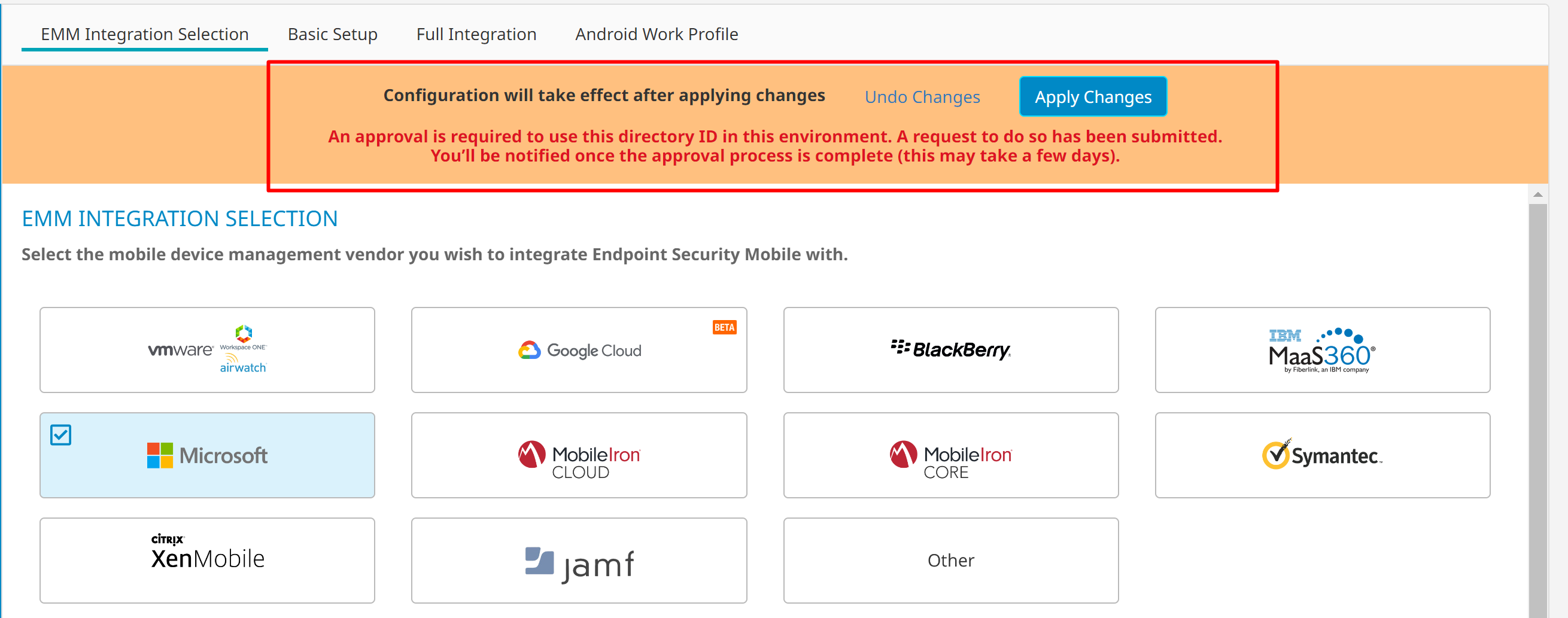

- If the MCs being used for multitenancy do reside on the same data center, then the following error will appear when attempting to add the Intune directory ID:
Note: There is no automatic notification sent to Broadcom Support when this message appears - if the above message is seen, please open a Support case and request assistance enabling Intune multitenancy with SEP Mobile.  Please inform the Support engineer that an Engineering ticket will be needed to complete the multitenancy override, and refer to this article if needed.
