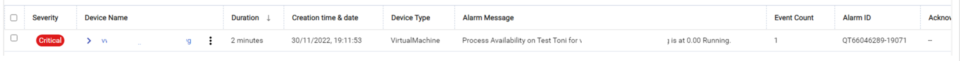

Create processes profile via MCS and check for process.
Alarm is coming à ok
When the process was running again, the alarm was not cleared.
A new alarm was generated with a new pid but didn't clear the original alarm.

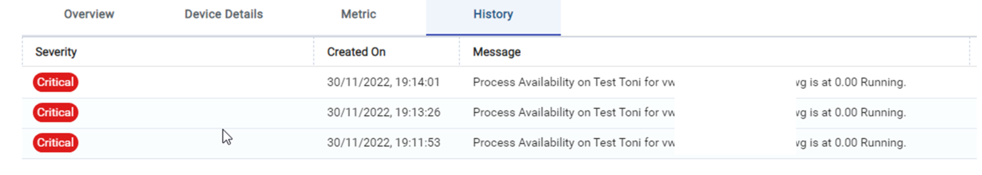

Once the monitored process is deactivated, after approx. 1-2 minutes time, more than 1 alarm is generated due to the process being down. The alarms displayed different NIMIDs.
Also the 2nd alarm with a different NIMID (when tracking by PID), sometimes shows up approx. 1-2 minutes later.

  • But, if multiple processes are being monitored in a single processes profile, e.g., an application that has multiple processes or an application running multiple times on a given machine, and the processes are all being monitored under that profile, a Profile-level alarm is generated. This is currently 'working as designed' as per testing while using MCS and Non-MCS (IM).
  • This causes multiple alarms to be generated (1 for the profile, and 1 for the process) which is NOT ideal/optimal.
  • What if you are monitoring MULTIPLE processes?
    • Testing results: No matter HOW MANY processes are being monitored under 1 profile you only get 2 alarms, 1 for the profile and 1 for a single process. This is somewhat confusing and doesn't make sense.
