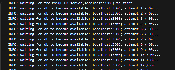

If in the Portal configuration file we point the Database to "localhost" (PORTAL_DATABASE_HOST=localhost), the implementation routine will fail because unable to connect to the database. The following error can be seen in the log of [portal_db_upgrade] container:
Portal 5.x - MySQL: 5.7/8.x
The reason for the inability of Portal deployment to connect the database is because the Portal Upgrade container cannot resolve "localhost". The container is a virtual machine with its own virtual network and localhost is not the underlying system that is hosting Docker service, but is the container itself.

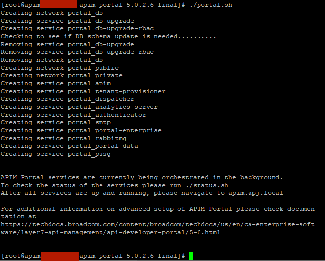

- then deploy the Portal by executing the portal.sh script, which should be successful
- after a few minutes all Portal services should be up and running:
