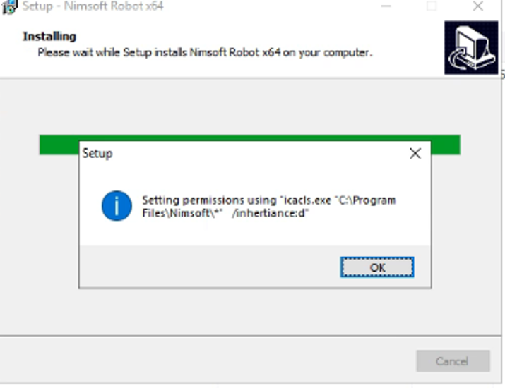

We have an error during robot installation on Windows 2019 OS server.
Error-setting permissions using icacls.exe
This may occur one or more times.
DX UIM - Windows Robot
If you are doing just a single installation, instead of using nimsoft-robot-x64, try running "NimBUS Robot.exe" and make sure to "Run As Administrator."
The robot installer is located in the primary hub at the location:
C:\Program Files (x86)\Nimsoft\install\setup  (or /opt/nimsoft/install/setup/ on Linux)
If instead you are using the nimsoft-robot-x64.exe for a bulk deployment, you can add the command line option /SUPPRESSMSGBOXES to avoid these popups.
