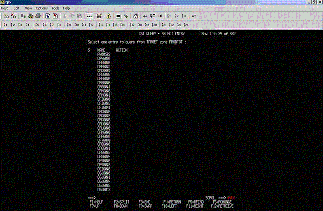

To create an online report using online SMP/E access, follow these basic steps, as demonstrated in the accompanying screen prints:
  1. Pull up the SMP/E main menu. The mechanism for this is site-specific; many sites can access this by choosing option "S" (SMP/E) from the ISPSTART "Primary Options Menu" from TSO / ISPF.
  2. On the SMP/E main menu, enter the name of the SMPCSI dataset that you want to query, and select option "3" to choose "Query" for the dataset.
  3. This will take you to the "Query Selection Menu". Specify option "1" for a "CSI Query".
  4. This will take you to a "CSI Query" screen. Specify "IDMSTGT" or your local name for the "Zone Name", "SYSMOD" for the "Entry Type", and "Entry Name" should be left blank. Hit Enter.
  5.
    You should see a list of the SYSMODs installed, which will include APARs, Usermods, and FMIDs for installed products.
  6. Determine which SYSMODs are FMIDs. FMIDs will begin with the letter "C", followed by a 2-digit code that corresponds to the product. Some Usermods may also begin with the letter "C', so those should be ignored, along with any SYSMODs that do not begin with "C".
