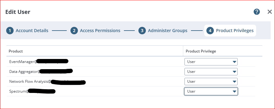

User access to the Data Source via Product Privileges configuration is set to None or User.
To check go to Administration -> User Settings -> Users. Edit the user logged into Portal showing the issue. Navigate to the Product Privileges area.
Sample where Users is the configured setting.
Edit the user and configure the users Product Privileges to a value other than None or User.
After saving the changes log out as the affected user, then log in again to validate the solution.
More details on the possible Product Privileges to assign are found on the Product Privilege documentation topic.
