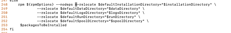

edit the install.sh and add --nodeps switch to the rpm command at the bottom of the script.
On line 248 add --nodeps after the ${rpmOptions}: see below
re-run the install.sh and the rpms should install
