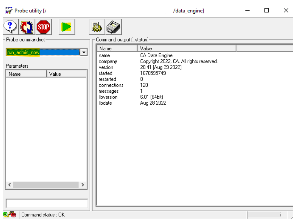

  5. Open the probe utility (Ctrl-P) for the data_engine and run the "run_admin_now" callback
  6. Check the logs and watch for the maintenance activity.
