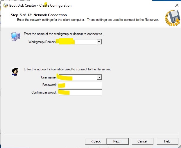

User with rights to remotely connect to 'eXpress' share has incorrect password configured in a pre-boot configuration
Edit the pre-boot configuration (PXE configuration utility or Boot Disk Creator) and go to modal screen 5 of 12 and re-enter the correct credentials for a user with rights to remotely connect to the 'eXpress' share
The 'eXpress' share is created on installation of GSS. Permissions for the share can be edited on the server by navigating to 'Computer Management' > 'Shared Folders' > 'Shares' > 'eXpress'
Once a user with rights to map a network drive to the 'eXpress' share have been configured, continue with finalizing until it is updated and saved.
