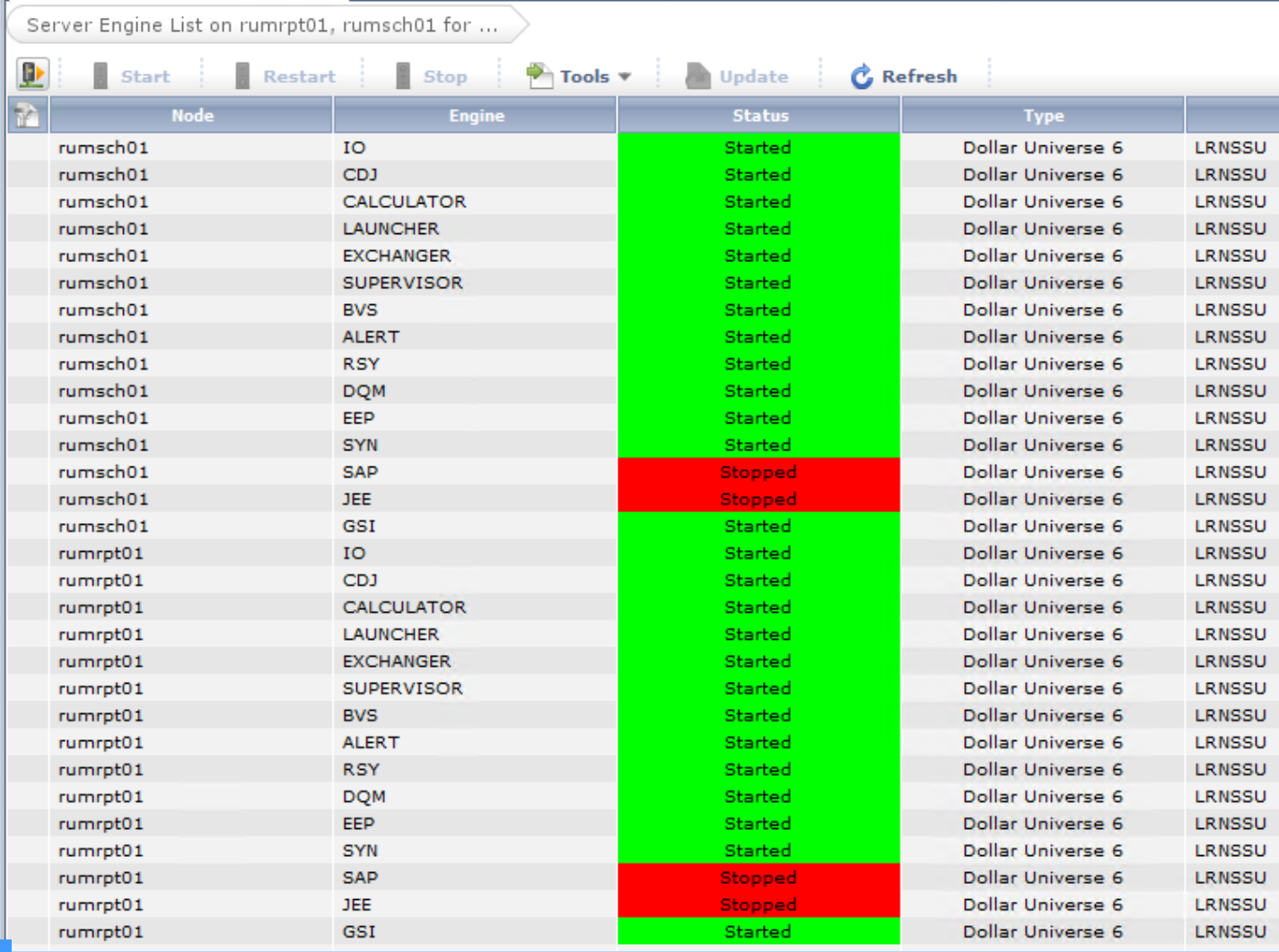

We installed new set of UVMS and DUAS in our UAT environment.  After installing a 2 new nodes i.e. rumrpt01 and rumsch01 we found that in Design-> Environment -> Nodes we don't see rumrpt01 node under context of rumsch01 node.
but if we switch context to the node rumrpt01 both the nodes are visible in Environment Node list
We validated and both nodes are connected fine to UVMS and server engine list are fine on both DUAS nodes.
