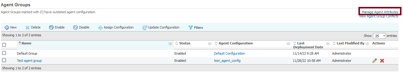

- Go to System > Agents > Agent Group and create an agent group for e.g. Test agent group (See below):

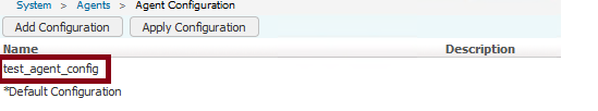

- Go to System > Agents > Agent Configuration and create an agent configuration for e.g. test_agent_config (See below):
- Assign the agent configuration to the agent group. See below:
- Click here to create agent attributes:
- Create an agent attribute with below parameters:

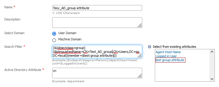

In the above figure, sAMAccountName=$LoggedinUser$ which means DLP agent reports Loggedin user to endpoint server thus
- Create a new attribute for AD security group with below parameters:
