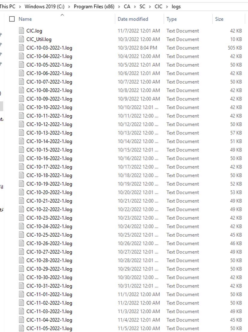

It's noticed that a CIC log with format "CIC-MM-DD-YY-1.log" are being created in a daily basis, causing that at certain point several files could be on the "logs" folder:

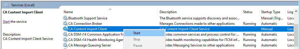

1.- CIC has to be stopped, but there is no way to clearly do it when CIC is not installed as a services (which is the default). In order to create CIC service, the following can be made:
- Navigate to ..CA\SC\CIC\bin
- Double.click on "OnlineServiceInstall.bat"
- A new "CA Content Import Client" service will appear, and be sure that the service is stopped:
