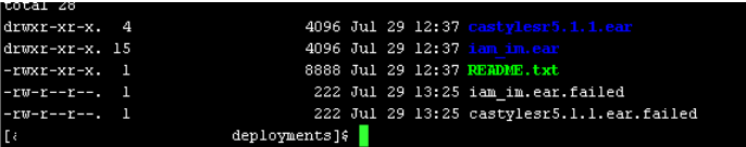

IM startup shows the Wildlfy/JBoss deployment marker files as *.failed instead of *.deployed and the deployment failed and startup log was stuck at 'FIPS mode enabled' line as shown below screenshot.
The iam_im.ear.failed and castylesr5.1.1.ear.failed file show the following error:
 "WFLYDS0022: Did not receive a response to the deployment operation within the allowed timeout period [600 seconds]. Check the server configuration file and the server logs to find more about the status of the deployment."
