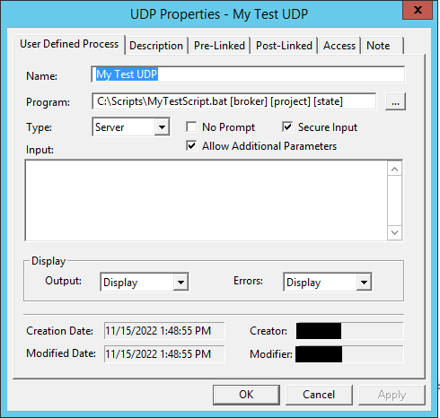

To see the properties for the above example "My Test UDP" process, in the Administrator Tool right click on the process name and select "Properties" from the menu.
The properties window for the example "My Test UDP" looks like this:
Two important thing to notice are
  • The "Program" field.  This will tell you the exact command or script the example "My Test UDP" is executing.
  • The "Type" field.  This will tell you if this command or script runs on the broker machine (Server) or on the machine where Workbench is running (Client).
In the above example, the command the UDP is running is
C:\Scripts\MyTestScript.bat [broker] [project] [state]
In the above example, C:\Scripts\MyTestScript.bat is the example custom script that is being run by the "My Test UDP" process, and the rest of the information in the Program field lists options or parameters (specific data values) being passed into the script.  (The "C:\Scripts\MyTestScript.bat" file in the above example is meant to be a placeholder.  Its contents aren't relevant except to demonstrate how to identify which user-developed script the UDP process is calling and where to find it.  "C:\Scripts\MyTestScript.bat" is just an example and you should substitute your script name and location there.)
If you see options or parameters in the Program field surrounded by square brackets, these are "Harvest System Variables".  They are not the operating system variables you would define outside of Harvest.  Instead these allow you to pass context-relevant information to the command or script such as the broker name, project or state, package, user, etc.  In the above example we are passing the broker name, the project name, and the state name into the script.
You should be able to execute the command or script you see in the Program field from a command prompt window.  If the "Type" field says "Server" it will run from a command prompt on the broker machine.  If the "Type" field says "Client" it will run on the machine where Workbench is running.  A good first test when diagnosing a problem with the UDP is to try to run it from the command prompt window, after substituting actual values for any "Harvest System Variables" specified on in the Program field.  For the above example, the command we will use to test is:
