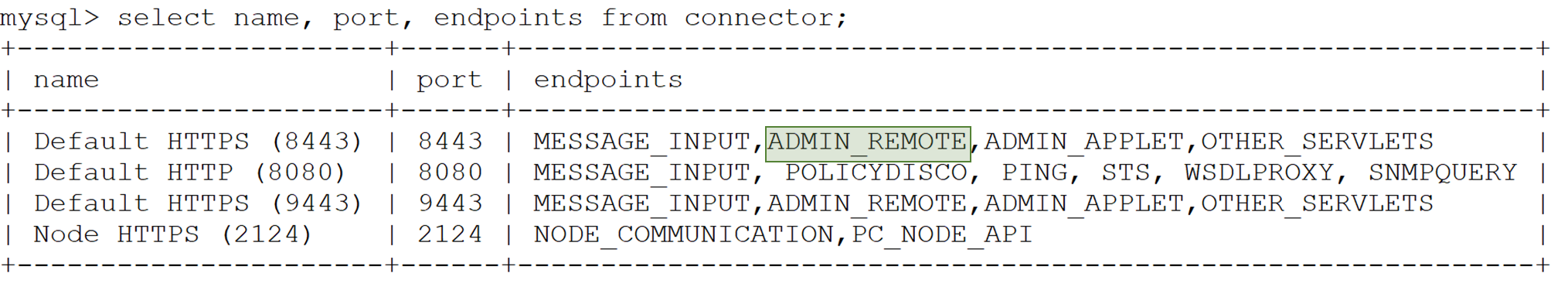

Per the description in the values.yaml file, the configuration for the default port was overridden. Even though the parameter was later disabled again, this did not revert the configuration of the default listen port. More than likely, the ability to log in to the Policy Manager has been removed from the port. You can check this by running the following command: mysql -e "select name, port, endpoints from connector;"
If you do not see ADMIN_REMOTE as an endpoint for port 8443, then it needs to be re-added.
To restore the default endpoints, log in to the MySQL database and run the following command:
UPDATE connector SET endpoints = 'MESSAGE_INPUT,ADMIN_REMOTE,ADMIN_APPLET,OTHER_SERVLETS' WHERE port = '8443';
FLUSH PRIVILEGES;
You will need to restart the gateway services for the change to take effect.
