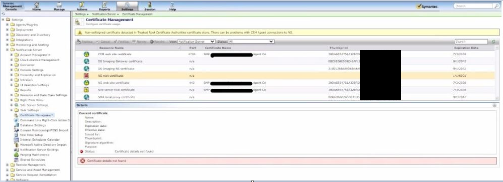

After migrating to a new SMP Server, the following error was noticed in the SMP Console under Settings>All Settings>Notification Server>Certificate Management:
NS root certificate
Certificate details not found

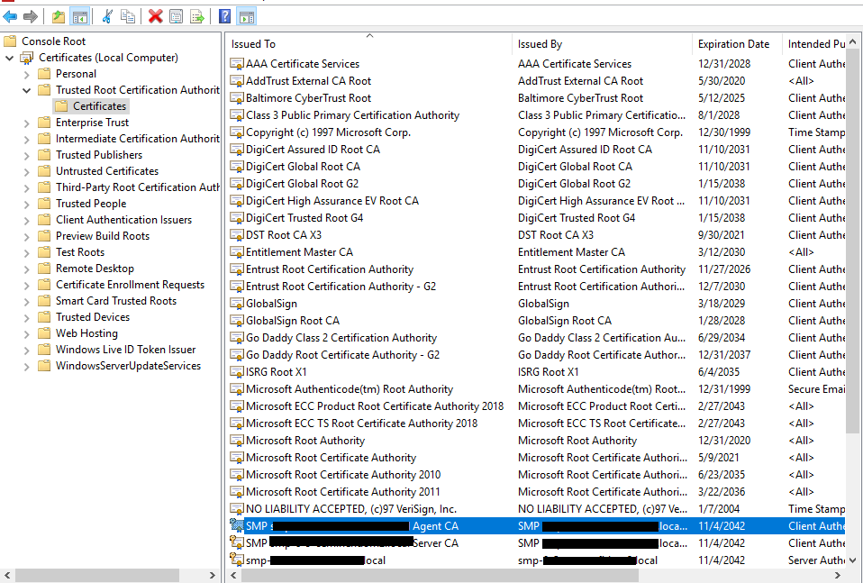

Note: You can find the required Agent CA certificate information under MMC on your SMP Server:
