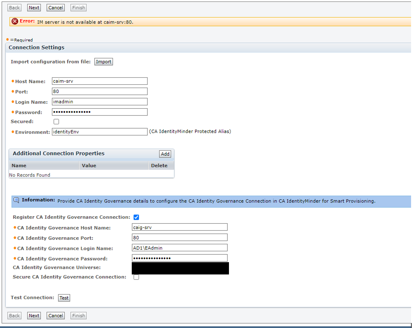

We receive an error following the directions for connecting Identity Governance to Identity Manager.  We have tried both the names in /etc/hosts file (caim-srv and caim-srv-02) and by IP address.
Error:
IM Server is not available at caim-srv:80
Release : 14.4
The issue was caused by VAPP not inserting the IM cert into the IG keystore. Follow the below steps to import the cert:

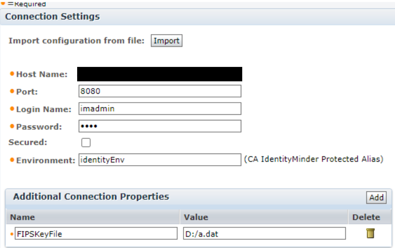

If you are FIPS enabled, you must declare the FIPS key location.
For VAPP the default location for the FIPS key is here:
 /opt/CA/wildfly-ig/modules/com/ca/iam/crypto/main/config/com/netegrity/config/keys/FIPSkey.dat
or
/opt/CA/wildfly-ig/fips/FIPSkey.dat
The below documentation covers enabling FIPS for IG. https://techdocs.broadcom.com/us/en/symantec-security-software/identity-security/identity-governance/14-4/configuring/security-and-encryption/how-to-enable-fips-140-2-encryption.html
