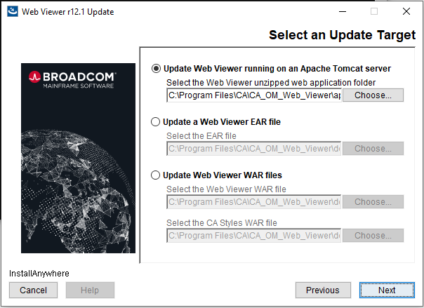

During the application of a CUMULATIVE BUILD you will be prompted to "Select an Update Target, Update Web Viewer running on an Apache Tomcat Server.......
However if you click Next to accept the default is not correct and your upgrade will not work
This problem is resolved with LU09689 Security or Integrity Problem (Cumulative Build 239)
This is the workaround if you are not at that build:
To recover: Install the build again:
4. Click in the path and go to the end and verify that the path specifies the Tomcat you are running. For example
C:\Program Files\CA\CA_OM_Web_Viewer\apache-tomcat-9.0.62\webapps\CAOMWebViewer12
5. If not correct,
Select Next and Complete the install.
