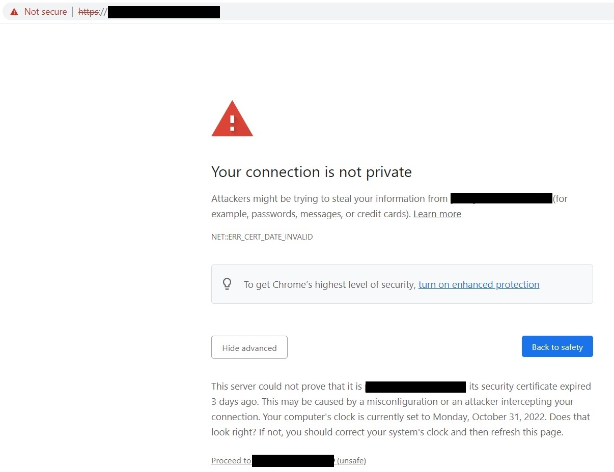

Error message in the requests for CA Process Automation portal (https://[PAM SERVER]:8443/):
This server could not prove that it is [PAM SERVER]:8443; its security certificate expired 3 days ago.
Specific error code: NET::ERR_CERT_DATE_INVALID
CA Process Automation r4.3 and above
