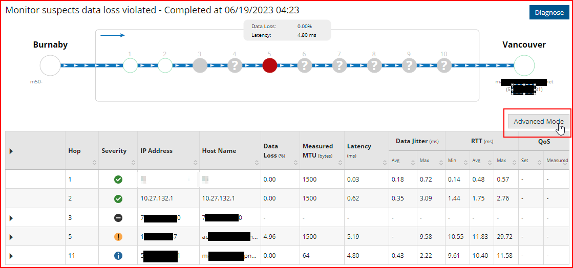

2. In the Configure User page ensure that the Advanced Diagnostics checkbox is checked and click on Update at the bottom of the page:
The user will now see the Advanced Mode button when viewing the Data or Voice details of a Diagnostic Test, note they will need to refresh any web browser tabs with diagnostic tests that were already open.
