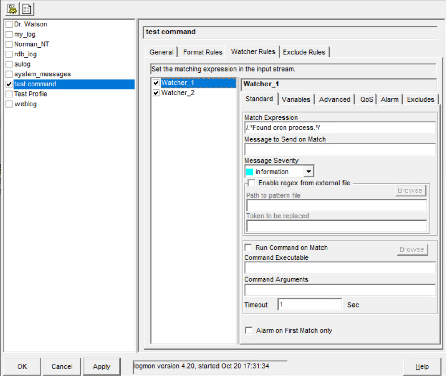

Set the Watcher_1 to the good Match result (process running):
Match expression-> /.*Found cron process.*/

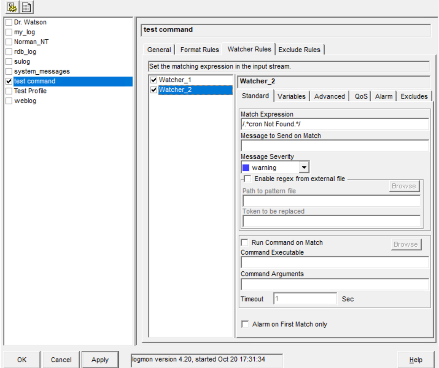

Set Watcher_2 to the bad Match result (process not running):
Match expression-> /.*cron Not Found.*/
Set the severity to warning (just an example).

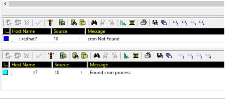

Sample alarms from this test:
