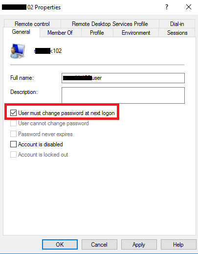

After creating a Global User and provisioned it to have correlated Windows NT account at the Access Control Endpoint, updating the Global User's password using Provisioning Manager always turns on "User must change password at next login" option at the NT Account, regardless of the settings of Account Template.
